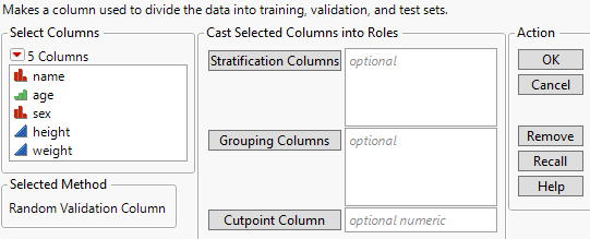

Launch the Make Validation Column platform by selecting Analyze > Predictive Modeling > Make Validation Column.
Figure 11.3 Make Validation Column Launch Window
The Make Validation Column launch window provides the following options:
