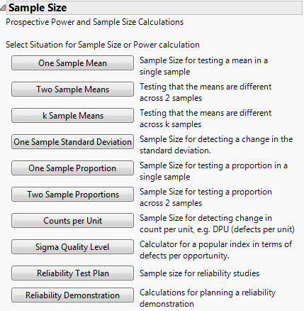

The Sample Size and Power platform is a collection of calculators for planning experiments or studies. Launch the Sample Size and Power platform by selecting DOE > Design Diagnostics > Sample Size and Power.
Figure 17.2 Sample Size and Power Launch Window
Choose from the following calculators:
• One Sample Mean Calculator
• Two Sample Means Calculator
• k Sample Means Calculator
• One Sample Standard Deviation Calculator
• One Sample Proportion Calculator
• Two Sample Proportions Calculator
• Counts per Unit Calculator
• Sigma Quality Level Calculator
• Reliability Test Plan Calculator
• Reliability Demonstration Calculator
