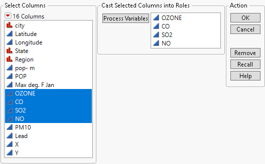

3. Specify the columns you want to set specification limits on. For this example, select OZONE, CO, SO2, and NO, and click Process Variables.
Figure A.1 Specify Columns
4. Click OK.

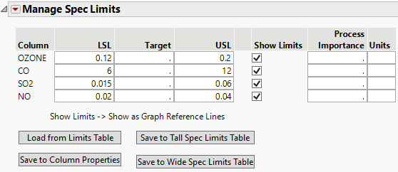

5. Add your specification limits. You can do this by loading existing limits from a JMP data table (Load from Limits Table) or by entering limits manually. For this example, enter the following limits manually:
– OZONE: LSL 0.12, USL 0.2
– CO: LSL 6, USL 12
– SO2: LSL 0.015, USL 0.06
– NO: LSL 0.02, USL 0.04
6. Click the red triangle next to Manage Spec Limits and select Show Limits All.
Specification limits for all columns will appear in graphs for any future analyses. If you want to show the specification limits only for individual columns, check the Show Limits box next to those columns.
Figure A.2 Set Specification Limits
7. Choose how you want to save the specification limits. For this example, click Save to Column Properties. This saves them as column properties in the corresponding data table. You could also save them to a new data table (tall or wide format).

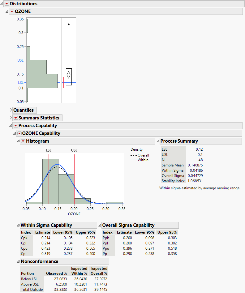

Figure A.3 Specification Limits for OZONE in Distribution
The specification limits that you added to the OZONE column appear in the histogram. Because the column contains a Spec Limits column property, the Distribution report also contains a Capability Analysis report.
