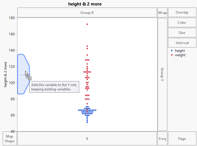

• If you are starting with an empty zone, highlight multiple variables from the list and drag them into the zone at the same time.
• If you already have variables in the zone and want to add more, drag the new variables to the inner side of the zone, in the graph area, until a symmetric polygonal shape appears.
Figure 3.11 New Variable Merged with Existing Variable
