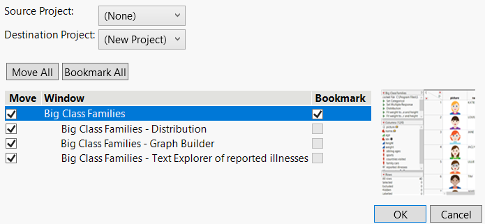

3. From any window, select Window > Move to/from Project.
4. Leave Source Project as “(None)” because you are not moving files from another project.
5. Leave Destination Project as “(New Project)” because you want to put the files in a new project.
6. Select the check box next to Big Class Families.jmp.
The graphs associated with the data table are also selected.
7. Click Bookmark next to Big Class Families.
A bookmark to the data table will be included in the project.
Figure 7.11 Moving Files to a New Project
8. Click OK.

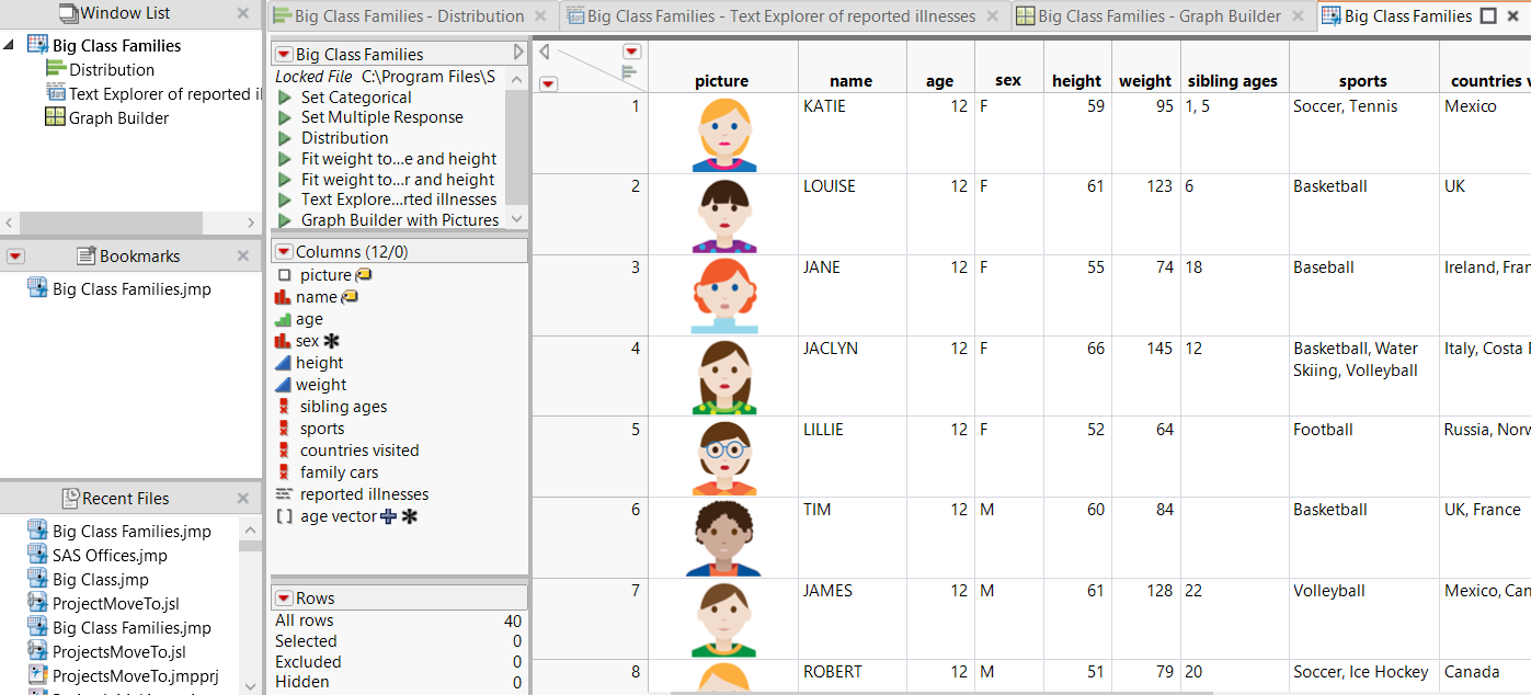

A new project with the selected files and bookmark appears.
