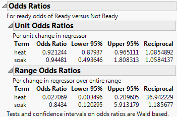

Odds Ratios
Shows or hides an Odds Ratios report that contains Unit Odds Ratios and Range Odds Ratios.
Figure 11.6 Odds Ratios
