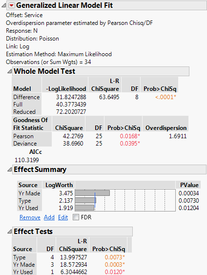

8. Click the check mark box for Overdispersion Tests and Intervals.
9. Click Run.
From the report, notice that all three effects (Type, Yr Made, Yr Used) are significant.
Figure 12.7 Partial Report for a Poisson with Offset Model
