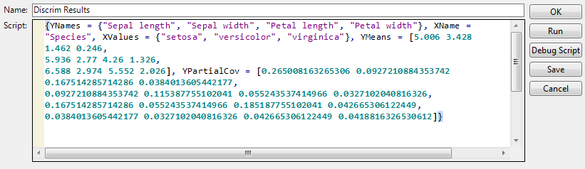

Consider the analysis obtained using the Discriminant script in the Iris.jmp sample data table. If you select Save Discrim Matrices from the Discriminant Analysis red triangle menu, the script Discrim Results is saved to the data table.
Figure 5.16 Discrim Results Table Script for Iris.jmp
