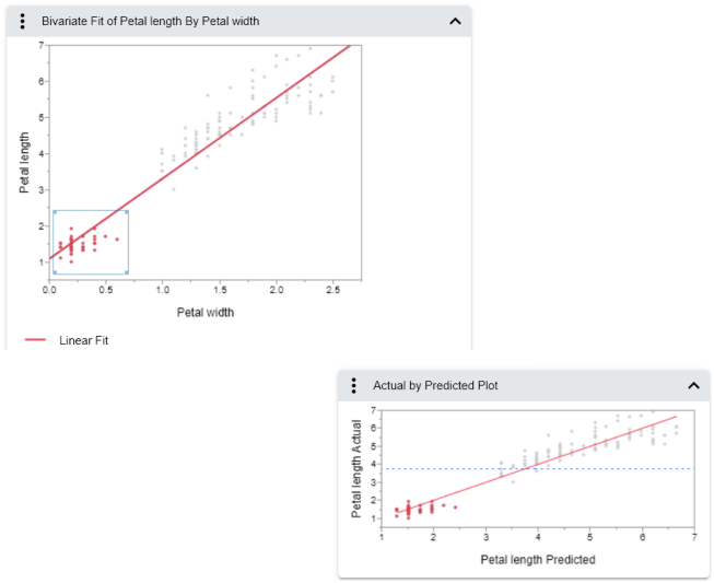

• Explore interactive graph features, such as selecting histogram bars and viewing data values.
• View data by brushing.

Figure 7.15 Brushing Data in Interactive HTML
