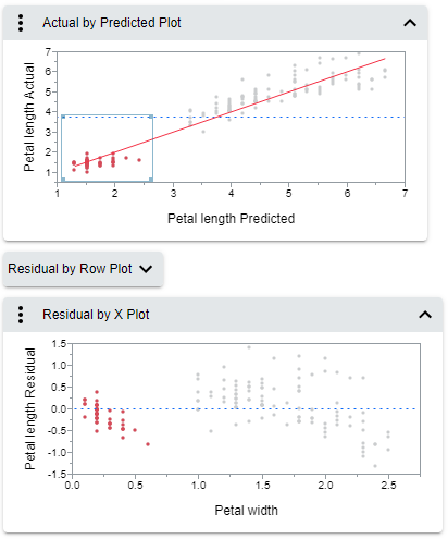

• Explore interactive graph features, such as selecting histogram bars and viewing data values.
• View data by brushing.
• Show or hide report sections.
Figure 10.3 Brushing Data in Interactive HTML
