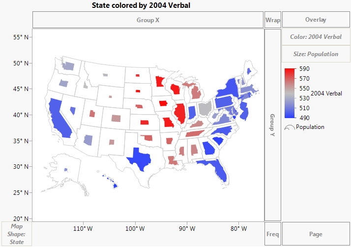

Size
Use the Size element to scale map shapes according to the size variable, minimizing distortion.
Figure 12.8 Example of SAT.jmp After Dragging Population to Size
