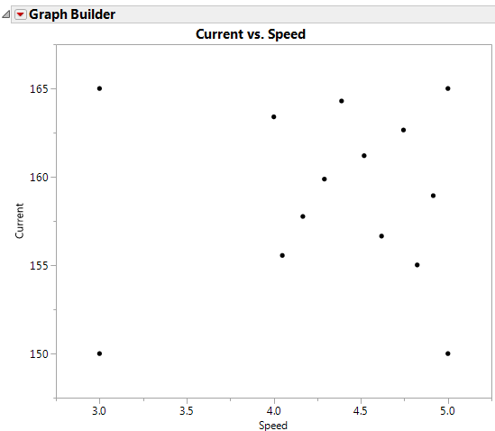

13. From the Augmented Design table, select Graph Builder.
14. Drag Speed to the X drop zone and drag Current to the Y drop zone.
Figure 6.18 Space Filling Augmented Runs
The augmented runs fill the space in the upper right corner of the design space. This is the constrained design space.
