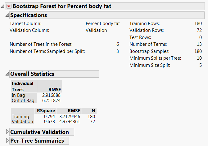

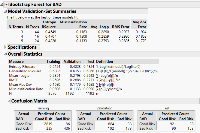

Figure 5.10 Bootstrap Forest Report for a Categorical Response
Figure 5.11 Bootstrap Forest Report for a Continuous Response
