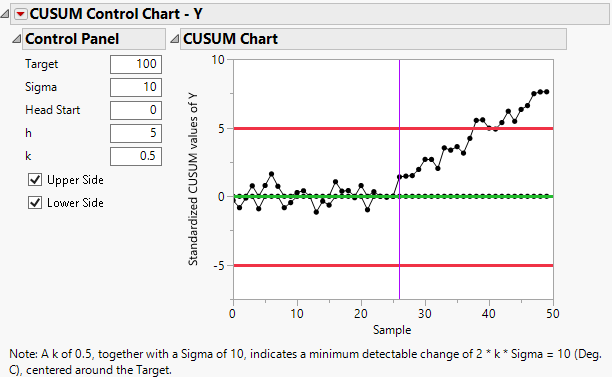

By default, the CUSUM Control Chart platform produces a report that contains a parameter control panel and a CUSUM chart.
Figure 8.4 CUSUM Control Chart ReportĀ
