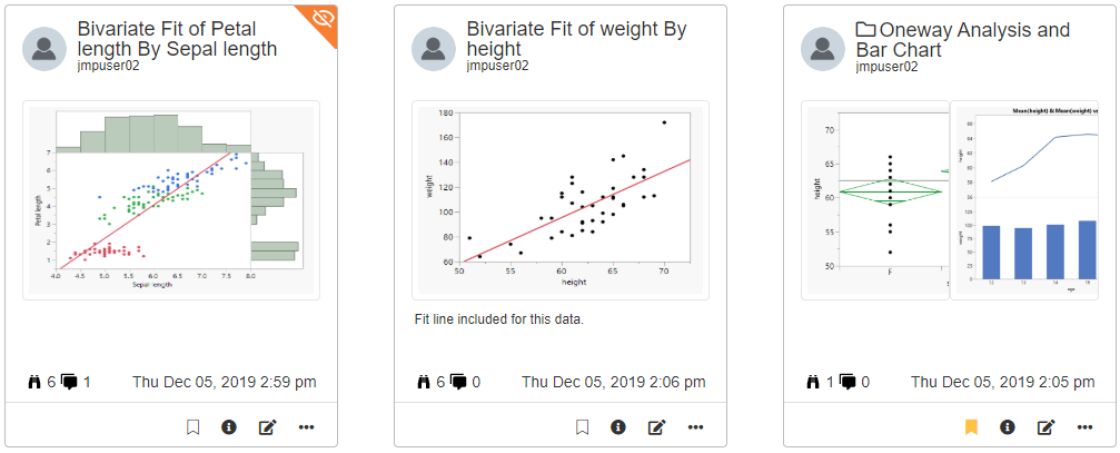

Publish JMP Graphs and Reports as Posts
You can use JMP 15 and above to publish graphs and reports to JMP Live. Graphs and reports appear in a JMP Live post, which can contain a single report or a folder with multiple reports. Create your graphs and reports in JMP and then click File > Publish. For more details, see Save and Share Reports.

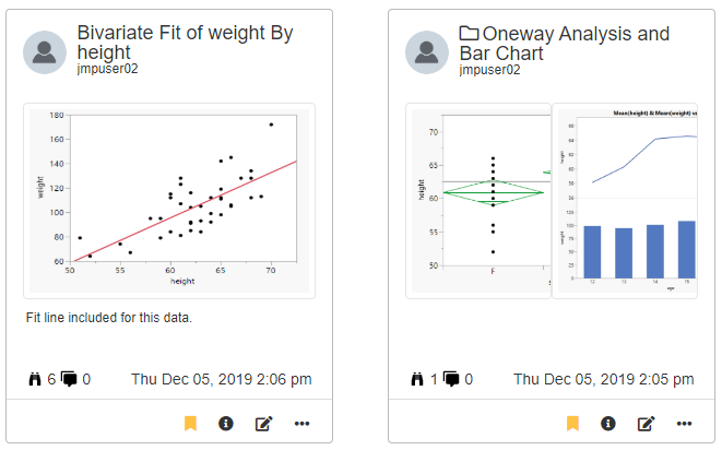

Figure 1.1 JMP Live Post Thumbnails
Icons indicate the following information:
Figure 1.2 Example of a JMP Live Post

Click a post to open it. If there is only one post, it opens directly. If there are several posts in a folder, click the folder to open it, then click the post that you want to see.
Figure 1.3 Single Post Thumbnail (Left) and Folder Thumbnail (Right)

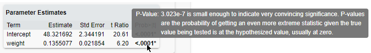

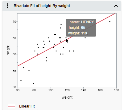

In a graph or a report, point your cursor or tap on a data point or a calculation to see its values or description.
Note: To open or close reports and graphs, click or tap the arrow to the right of the title.
Figure 1.4 See a Data Point’s Values
Figure 1.5 See an Explanation of a P-Value Calculation

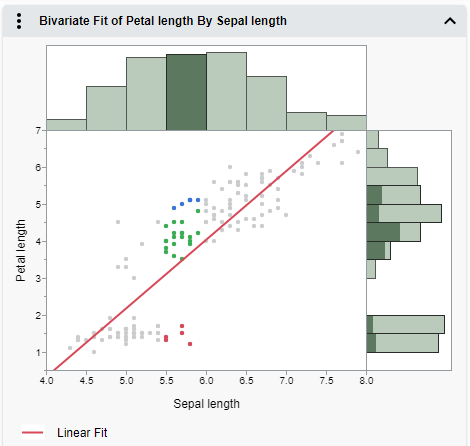

See Linked Data
If your JMP report contains multiple graphs, data in all graphs are linked. So if you select data, it is highlighted in all associated graphs.
Figure 1.6 Select Data in Linked Graphs
In this example, a histogram bar in the top graph is selected. The corresponding rows are highlighted in the scatterplot and in the marginal histogram.

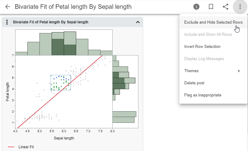

Exclude and Hide Data
Once you have selected data, you can exclude it from report calculations and hide it in graphs. Reports and graphs automatically update.
Figure 1.7 Report Menu Options
To exclude and hide data, use the options in the More
menu at right:
Note: If the report contains a Local Data Filter, most of these options do not appear, since you use the Local Data Filter instead.
Exclude and Hide Selected Rows: Excludes and hides selected data.
Include and Show All Rows: Includes and shows any excluded or hidden data.
Invert Row Selection: Changes the current selection to the deselected data.

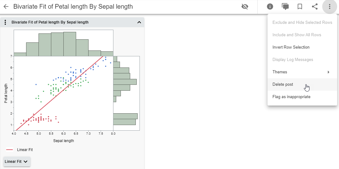

Delete post: (Appears only on posts you own) Deletes the post. See Delete Posts.
Flag as inappropriate: Flags the post as inappropriate. See Flag Posts or Users.

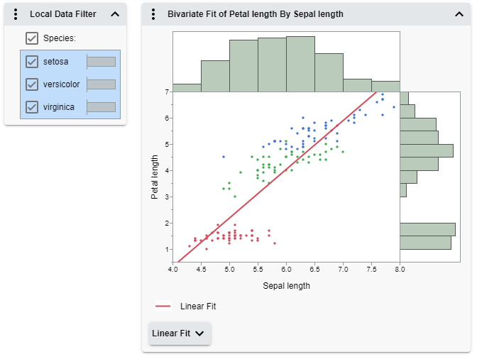

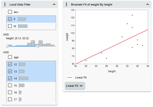

Filter Data
If the original JMP report included a Local Data Filter, you can use it to focus on specific data and see the impact on graphs and reports.
Figure 1.8 Filter Data in Graphs
In this example, the filter choices are showing only females between 51 and 63 inches tall who are between the ages of 12 and 14.

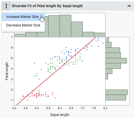

Figure 1.9 Change the Marker Size
The options in this menu can vary depending on the type of graph or JMP platform. For example:
In scatterplots and histograms, you can change the marker size.

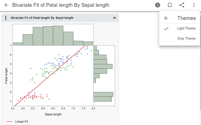

Change the Theme
To change the page appearance, at the top right, click More
> Themes.
Figure 1.10 Change the Page Theme

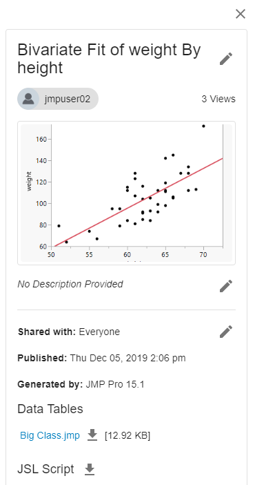

Edit Posts or See Details
To edit a post that you created:
From a post thumbnail, click Edit
From within a post, click Details
To see details about a post from a thumbnail, click Details
.You can see when the post was published or the underlying data.
Figure 1.11 Edit a Post’s Details
You can download the associated data table(s) and the JSL script that re-creates the post.

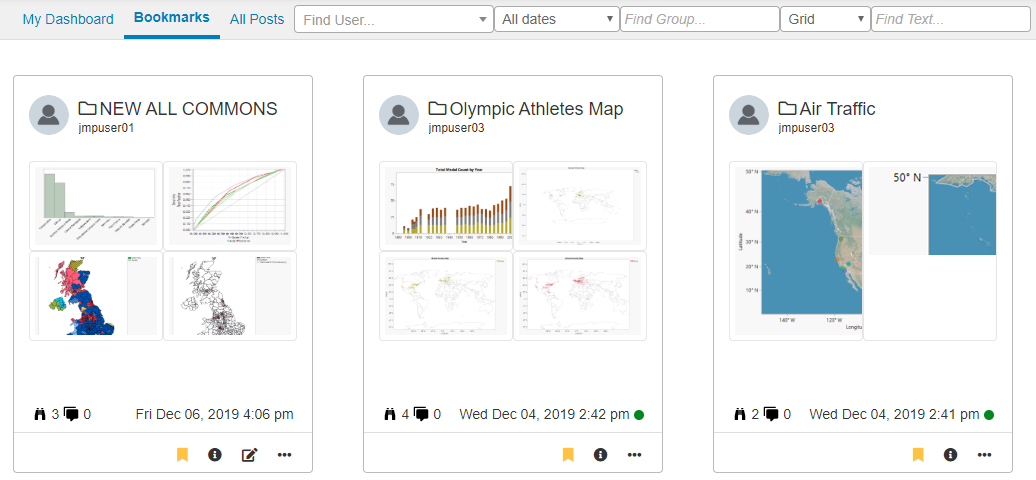

Bookmark Posts
If you want to easily access a stand-alone post or a folder containing several posts, you can bookmark it in JMP Live.
Note: In a folder, you cannot bookmark individual posts, but you can bookmark the entire folder.
To bookmark a stand-alone post or folder, click Bookmark
. To see all your bookmarked posts and folders, at the top, click Bookmarks.
Figure 1.12 Bookmarks Page
Tip: On the Bookmarks page, updated posts have a green dot next to their timestamp. After you view the post, the green dot disappears.

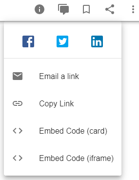

Share Posts
From a post, click Share
to share the post. You can share a post in any of these ways:
on social media: Facebook, Twitter, LinkedIn
Note: These options do not appear if your administrator has disabled them.
email a link
copy a link
copy embedded HTML code (for a web page)
Figure 1.14 Sharing Options
Note: If you are sharing your own post, you might not see all of these options if the sharing setting is restricted to only you. Share your post publicly to see these options.

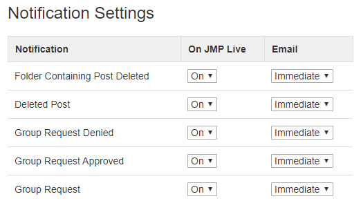

Manage Notification Settings
On the Notification Settings page, you can choose which types of notifications you want to receive and how often you want to get email notifications.
Stop receiving a notification of a certain type: Under On JMP Live, click Off.
Change how often you get email notifications: Under Email, choose a time period.
Figure 1.15 JMP Live Notification Settings

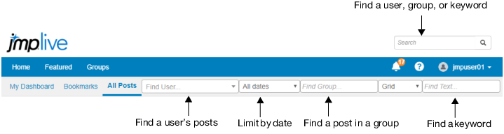

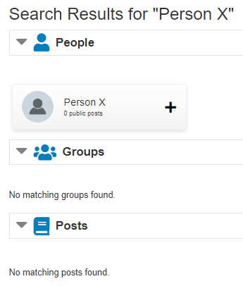

Search for People, Posts, or Groups
You can search JMP Live in these ways:
To search all of JMP Live, enter a name or keyword in the search box at top right.
To filter posts on the Home pages, enter text in the Find User, Find Group, and Find (keywords in posts) boxes. See Filter Your Search.
Figure 1.16 Search Options (JMP Live and JMP Public)
Filter Your Search
To use filters, depending on where you want to search, go to Home > My Dashboard or All Posts.
To find all posts from a user or group, enter a user name or group name in the Find User or Find Group box. Suggestions appear as you type.
To search by a keyword in a post title, enter a word into the Find box.
You can refine your search by restricting the date or by limiting it to a certain group.
To clear your search, click the x next to a user name, or clear other fields by clicking Clear All.

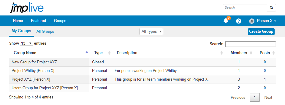

JMP Live Groups
There are different types of groups in JMP Live:
Personal groups: Users and administrators can create personal groups. Only people that you add to a personal group can see the group and its posts. Personal groups can be owned by the creator of the group, or by a member that you specify as an administrator of the group.
Open, Closed, or Hidden groups: Only administrators can create these types of groups.
Open: Anyone can find the group, join the group, and see the posts and members.
Closed: Anyone can find the group, but only members can see the posts and members. People can request to join the group.
Hidden: Only members can find the group and see posts and members.
On the Groups page, you see My Groups or All Groups:
My Groups: Shows all groups that you are a member of.
All Groups: Shows all groups that you are a member of and all open and closed groups that you can join or ask to join.
Figure 1.18 My Groups Page
When you add someone to a group, they are added automatically. They can choose to leave the group.
Create JMP Live Groups
Click Groups.
Click Create Group.
Figure 1.19 Create New User Group
Name the group.
(Optional) Add a group description.
5.
Click Find user and type user names to add members.
Clickable suggestions appear as you type.
6.
Click Create.

then tap a data point.
then tap multiple data points.
then draw a rectangle over the data points. Drag the center to move the rectangle, or drag the corners to resize it.
