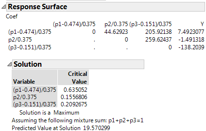

3. Click Run to see the response surface analysis.

The Response Surface Solution report shows that a maximum predicted value of 19.570299 occurs at point (0.63505, 0.15568, 0.20927).
Figure 13.24 Mixture Response Surface Analysis
