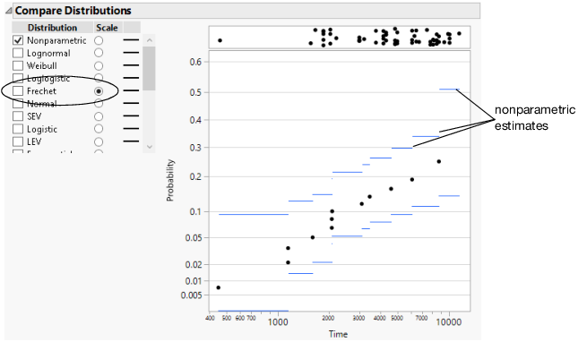

Figure 3.14 Nonparametric Estimates with a Fréchet Probability Scale
Using a Fréchet scale, the nonparametric estimates approximate a straight line, meaning that a Fréchet fit might be reasonable.

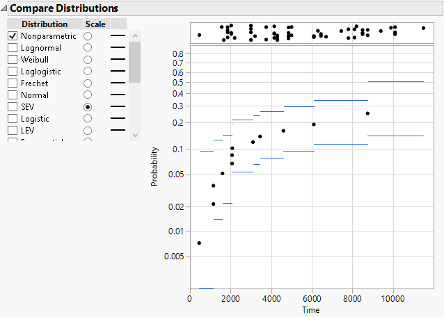

4. Select SEV in the Scale column.
The nonparametric estimates no longer approximate a straight line. You now know that the SEV distribution is not appropriate.
Figure 3.15 Nonparametric Estimates with a SEV Probability Scale
