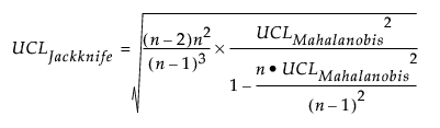

The UCL reference line (Penny 1996) drawn on the Jackknife Distances plot is calculated as follows:
