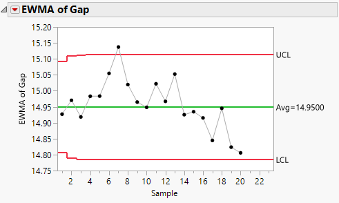

Figure 9.3 EWMA Chart
The EWMA chart appears for the same data shown in Figure 9.2. This EWMA chart was generated for weight = 0.5.
