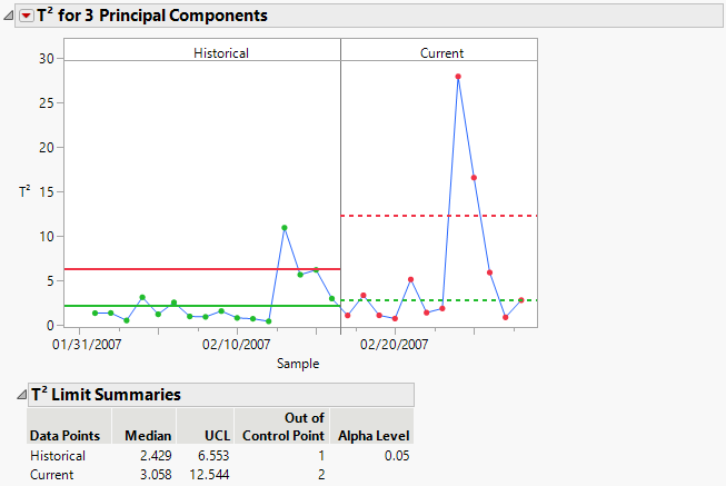

Figure 11.9 T2 Chart for Historical and Current Data
Note that there are two sets of limits. One set applies to the historical data. A second set of limits applies to the current data. For more information about how the historical data is used to calculate the two sets of limits, see Limits.
