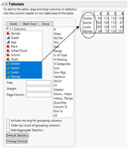

2. Select Analyze > Tabulate.
3. Select Grades, Sports, Looks, and Money and drag them into the Drop zone for rows.
Figure 9.20 Columns by Categories
Notice that a single, combined table appears.

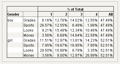

Tabulate the percentage of the one to four ratings of each category.
4. Drag Gender into the empty heading at left.
5. Drag % of Total above the numbered headings.
6. Drag All beside the number 4.
Figure 9.21 Gender, % of Total, and All Added to the Table

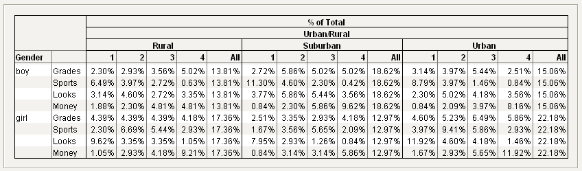

7. Drag Urban/Rural below the % of Total heading.
Figure 9.22 Urban/Rural Added to the Table
You can see that for boys in rural, suburban, and urban areas, sports are the most important factor for popularity. For girls in rural, suburban, and urban areas, looks are the most important factor for popularity.
