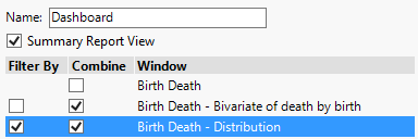

4. Select Summary Report View to display the graphs and omit the statistical reports
5. In the Combine column, select Birth Death - Bivariate of death by birth and Birth Death - Distribution.
6. In the Filter By column, select Birth Death - Distribution.
Figure 7.19 Combine Windows OptionsÂ
7. Click OK.

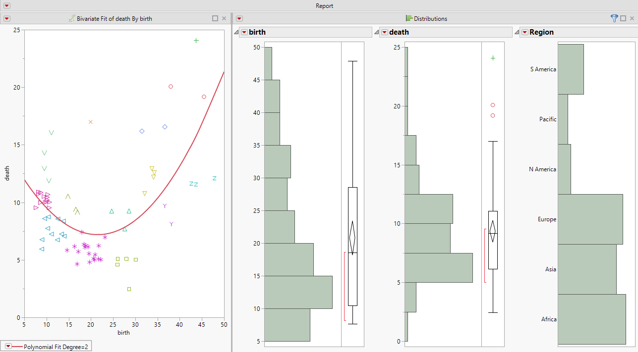

The two reports are combined into one window. Notice the filter icon
at the top of the Distribution report. When you select a bar in one of the histograms, the corresponding data in the Bivariate graph are selected.
