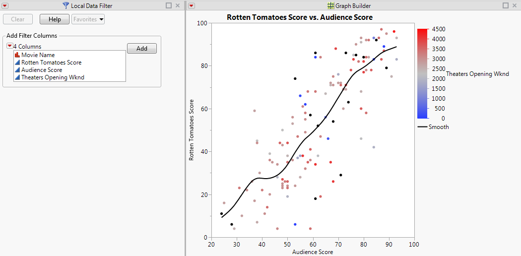

Create the Dashboard
1. From the report window, select File > New > Dashboard.
2. Select the Blank Dashboard template.
3. Double-click the Data Filter(Local) box in the left pane to add it to the dashboard.
4. Double-click the Graph Builder report in the left pane to place it next to the local data filter.
Figure 11.15 Dashboard for Hollywood MoviesĀ
