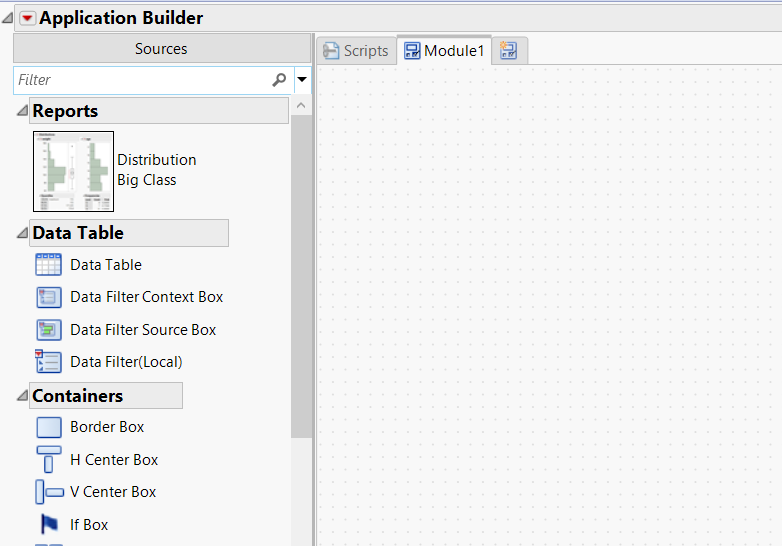

3. Select File > New > Application (or File > New > New Application on macOS).
4. Click the Blank Application box.
A new blank application appears. Notice the Distribution report in the left column.
Figure 16.2 New Application with Distribution Report in the Sources PaneĀ
5. In the Sources pane, drag the Distribution report onto the application workspace (the blank area on the Module1 tab).

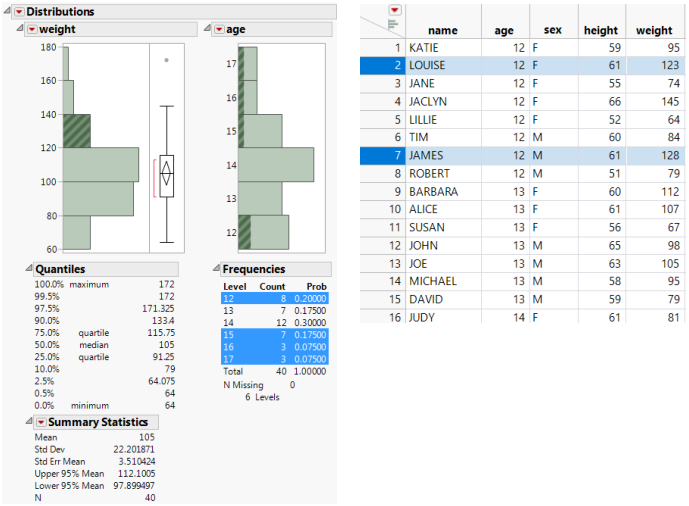

6. Click the Application Builder red triangle and select Run Application.
The Distribution report appears in a new window. Note that the histograms are interactive and still associated with the data table. When the data changes, you run the application again, and the Distribution report is updated.
Figure 16.3 Example of an Instant ApplicationĀ
