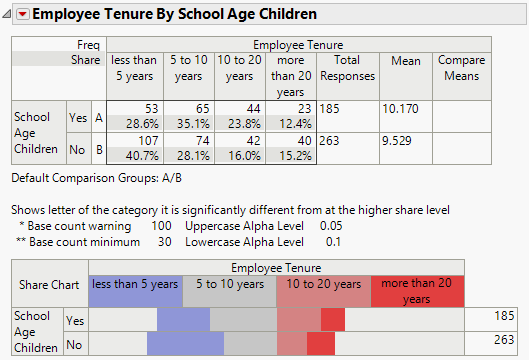

Figure 3.41 Categorical Report with Mean ScoresĀ
The mean employee tenure for those with school age children is 10.17 and 9.53 for those without school age children. Because the means are not statistically different, the Compare Means column in the Crosstab table is empty. If there were a difference, a letter would indicate the difference. If you had not used value scores, then the mean for those with school age children would be 2.20 and 2.057 for those without school age children.
Tip: Be aware of how your data are recorded when using the mean score option. If your data are recorded as coded numeric data with value labels, the mean value calculations are based on the numeric data. If the numeric values do not have meaning, use the Value Score column property to assign meaningful values to the response levels.
