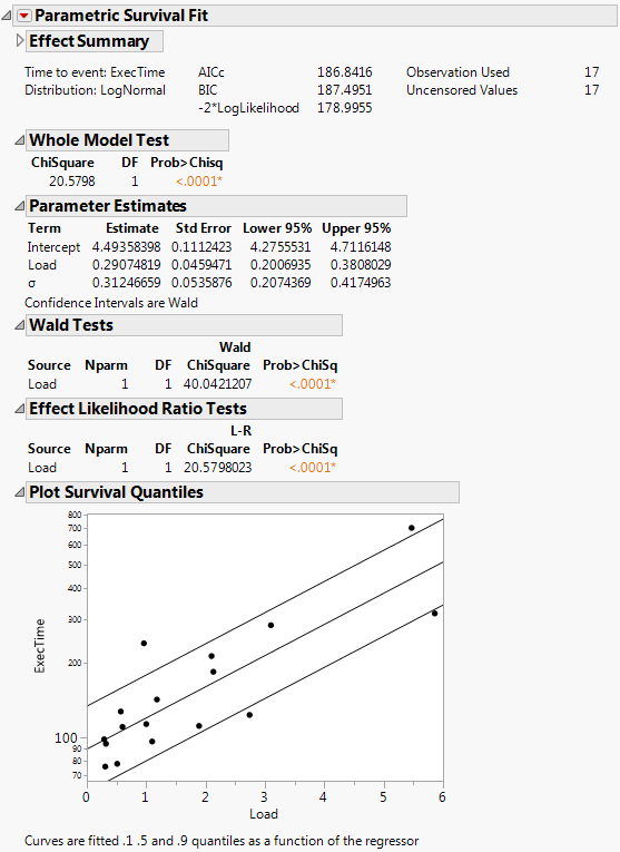

Figure 14.2 Computing Time Output
When there is only one effect, a plot of the survival quantiles for three survival probabilities are shown as a function of the effect.

Figure 14.3 Estimates of Time Quantile
The report estimates that 90% of the jobs will be done by 571 seconds of execution time under a system load of 5.
