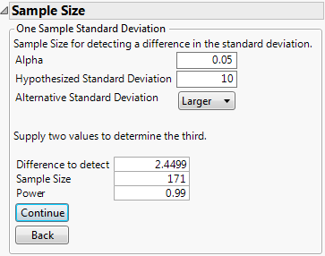

Figure 17.11 One-Sample Standard Deviation Calculator
You must test 171 wafers in order to have a 99% chance of detecting an increase in the standard deviation of 2.4499 from a standard deviation of 10, with an alpha of 0.05.
