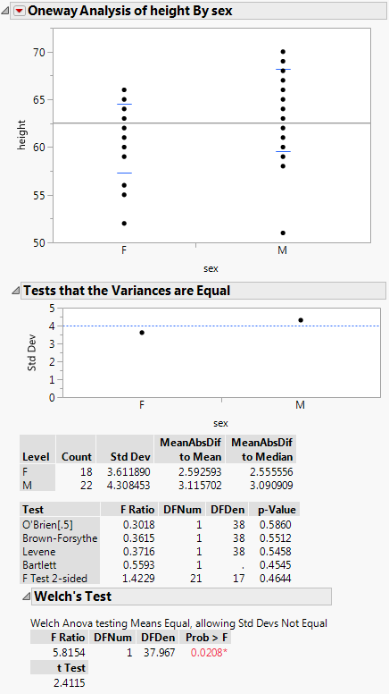

6. Click the red triangle next to Oneway Analysis of height By sex and select Unequal Variances.
Figure 6.29 Example of the Unequal Variances ReportĀ
Since the p-value from the 2-sided F Test is large, you cannot conclude that the variances are unequal.
