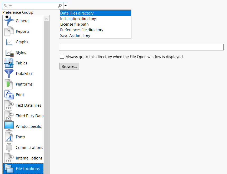

(Windows only) File Locations preferences set the default locations of JMP system files. Usually, the files can stay where JMP installs them, and you do not have to change anything here. However, if you do move files, update the location here.
Figure 13.16 File Locations Preferences
Table 13.16 Preferences on the File Locations Page
