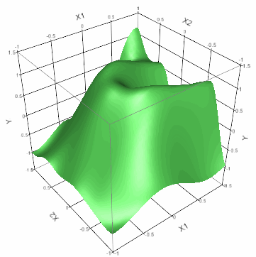

Figure 16.1 Gaussian Process Prediction Surface Example
