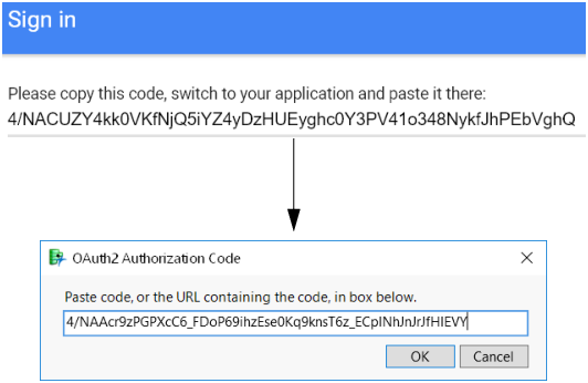

If you are importing data using the specified Google account for the first time, you are prompted to give JMP access to your Google account.
a. Click Allow.
b. Copy the authorization code that appears.
c. In JMP, paste the code in the OAuth2 Authorization Code box, then click OK.
Figure 3.69 Authorization Code
