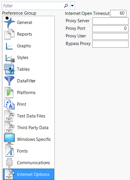

Internet Options specify settings for opening files from the Internet.
Figure 13.15 Internet OptionsÂ
Preference | Description |
Internet Open Timeout | When you use Internet Open to open a web page, JMP waits the specified number of seconds before stopping the import due to an error. 60 seconds is the default value. |
Proxy Server | Specifies the proxy host. http (or https) needs to be included with the specification. http is assumed if no protocol is used. |
Proxy Port | Specifies the port used to connect to the proxy host. If none is specified, the port is 443 (for http) and 1080 for all others (https). |
Proxy User | Specifies an optional user for the proxy. Not all proxy settings require a user. |
Bypass Proxy | Specifies an optional comma-separated list of hosts to bypass (that is, not going through a proxy). A user might want to filter out hosts that are behind the corporate firewall (which don’t require a proxy). |
