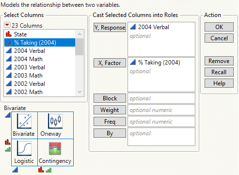

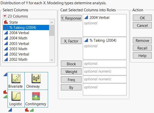

To perform a bivariate analysis, do the following:
1. Select Analyze > Fit Y by X.
2. Enter a continuous column for Y, Response.
3. Enter a continuous column for X, Factor.
Figure 5.3 The Bivariate Launch Window
The word Bivariate appears above the diagram, to indicate that you are performing a bivariate analysis.
