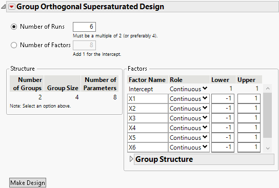

Launch the Group Orthogonal Supersaturated Design platform by selecting DOE > Special Purpose > Group Orthogonal Supersaturated > Group Orthogonal Supersaturated Design.
Figure 25.2 Group Orthogonal Supersaturated Design Launch Window
For more information about this window, see Specify Factors, Structure, and Make Design
