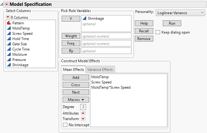

Launch the Loglinear Variance personality by selecting Analyze > Fit Model, entering one or more columns for Y, and selecting Generalized Regression from the Personality menu.
Figure 10.1 Fit Model Launch Window with Loglinear Variance Selected
For more information about aspects of the Fit Model window that are common to all personalities, see Model Specification. For more information about the options in the Select Columns red triangle menu, see Column Filter Menu in Using JMP. Information specific to the Loglinear Variance personality is presented here.
