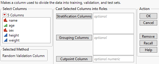

Figure 11.3 Make Validation Column Launch Window
The Make Validation Column launch window provides the following options:
