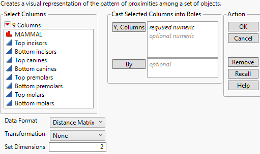

Launch the Multidimensional Scaling Platform by selecting Analyze > Multivariate Methods > Multidimensional Scaling.
Figure 10.4 Multidimensional Scaling Launch Window
Y, Columns
The columns to be analyzed. These must have a Numeric data type.

Data Format
MDS supports two data formats:
Distance Matrix
A full symmetric, lower, or upper triangular matrix where the number of rows equals the number of columns.The diagonal entries can either be zeros or missing.
Attribute List
A set of columns that contain measures of a quality or characteristic of an object. The objects are typically named in a column. The object column is not used in the analysis but rather is used as a label for the data points on the MDS plot.
Transformation
Supported transformations are Ratio, Interval, and Ordinal.
None
No transformation used.
Ratio
Data has an ordering from smallest to largest, the differences between values have meaning, and the scale has a true zero. Used to scale the MDS plot.
Interval
Data has an ordering from smallest to largest and the differences between values have meaning. Used to scale and shift the MDS plot.
Ordinal
Data has an ordering from smallest to largest. Used for ordinal data.
Set Dimensions
The number of dimensions for the visual representation of the proximities among your objects. Typically, two or three dimensions are used. With greater than three dimensions, the visualization becomes complex.
Note: The dimension selected can be between 1 to n - 1 where n = the number of objects, otherwise the dimension is set to 2.
