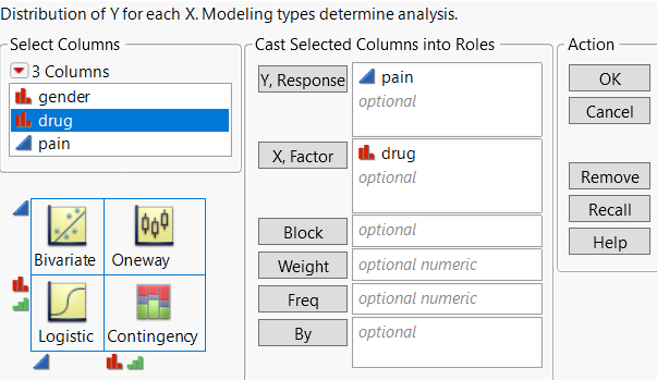

To perform a one-way analysis, do the following:
1. Select Analyze > Fit Y by X.
2. Enter a continuous column for Y, Response.
3. Enter a nominal or ordinal column for X, Factor.
Figure 6.4 The Fit Y by X Launch Window
The word Oneway appears above the diagram, to indicate that you are performing a one-way analysis.
