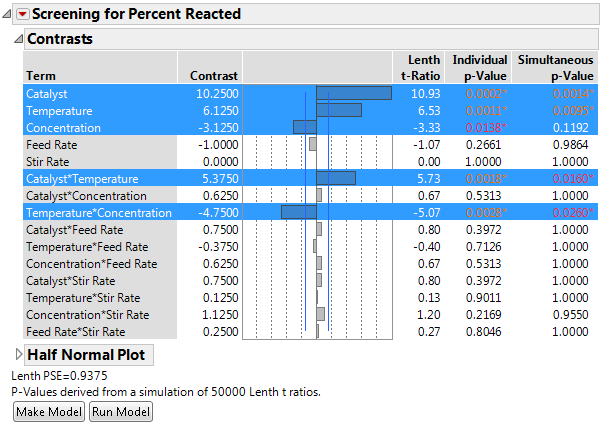

Monte Carlo Simulation Options
To change the number of default sets of simulations from 10,000, you must assign a value to a global JSL variable named LenthSimN. The number of simulations used to derive the p-values is reported in the report window.
The following example sets the number of simulations to 50,000.
1. Select Help > Sample Data Library and open Reactor Half Fraction.jmp.
2. Select DOE > Classical > Two Level Screening > Fit Two Level Screening.
3. Select Percent Reacted and click Y.
4. Select Feed Rate through Concentration, click X, and then click OK.
5. Click the red triangle next to Screening for Percent Reacted and select Save Script > To Script Window.
6. Insert LenthSimN=50000; as the first line of the script.
LenthSimN=50000;
Fit Two Level Screening(
	Y( :Percent Reacted),
	X( :Feed Rate, :Catalyst, :Stir Rate, :Temperature, :Concentration )
7. Right-click in the script window and select Run Script.
Figure 10.10 Fit Two Level with N = 50,000 Simulations for p-Value DerivationsĀ
The number of simulations is stated in the report window.
