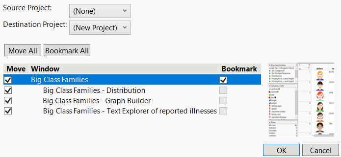

6. Select the check box next to Big Class Families.jmp.
The graphs associated with the data table are also selected.
7. Click Bookmark next to Big Class Families.
A bookmark to the data table is included in the project.
Figure 10.23 Moving Files to a New Project
8. Click OK.

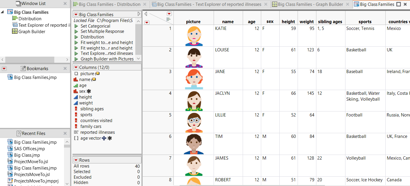

A new project with the selected files and bookmark appears.
