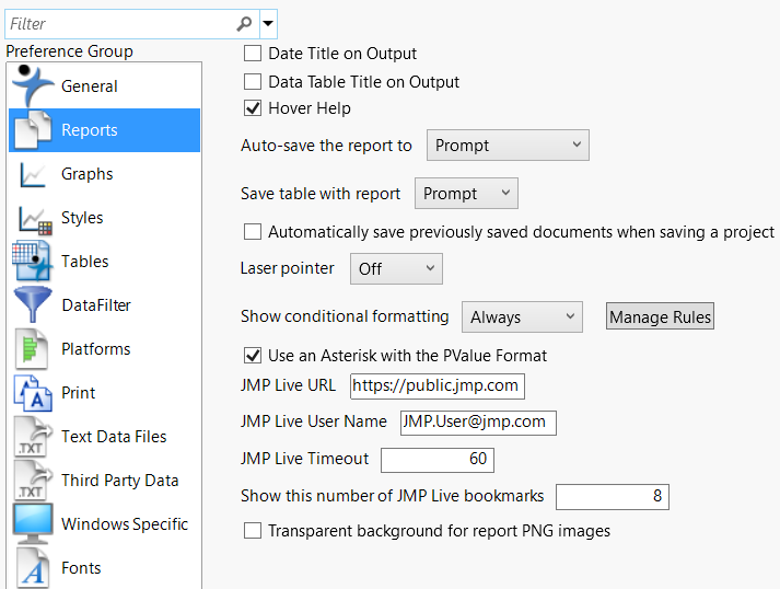

Report preferences customize the appearance of reports.
Figure 13.2 Reports Preferences
Preference | Description |
Date Title on Output | Select this option to display the date and time the analysis occurred in your report windows. This option is cleared by default. |
Data Table Title on Output | Select this option to display the name of the data table and notes, if there are any, at the top of the report. This option is cleared by default. |
Hover Help | On some numeric output, JMP provides tooltip-style help when you circle the mouse over a result. Select this option to see a tooltip where it is available. This option is selected by default. Note: If you turn off this option, hover label graphs no longer appear. |
Auto-save the report to | Select one of the options from the menu to determine where a report is saved: Prompt When you close a report, you are prompted for a location to save it. This is the default selection. Data Table Script When you close a report, it is saved as a script in the open data table. Journal Script When you close a report, it is saved to a journal window. Log Window When you close a report, its script is written to the log window. |
Save table with report | Select one of the options from the menu to determine how a table is saved to a report: Embed When you save a report, the table is embedded into the report. Choose this option if you want to share the report with others. The data table that is stored in the report is reopened (unchanged) each time the report is opened. If you make changes to the table, they are not saved into the report unless you re-save the report. Separate When you save a report, the table is referenced in the report. Prompt When you save a report, you are prompted to specify how to save the report: either to embed the table within the report, or to add a reference to the table in the report. Prompt is selected by default. |
Automatically save previously saved documents when saving a project | Saves previously saved documents when you save a project. For example, if you saved a data table inside a project, the data table is saved automatically again when you save the project. |
Laser pointer | JMP has a built-in laser pointer that enables you to visually emphasize parts of a report. It is off by default. To turn it on, select a color for the laser pointer from the list. |
Show conditional formatting | Conditionally formats the color of the text that represents the values. Available for correlation values, p-values, and factor pattern values. Select one of the options from the menu: Always Conditional formatting is always applied to correlation values, p-values, and factor pattern values. Screen Only Conditional formatting is always applied to correlation values, p-values, and factor pattern values. However, the conditional formatting does not show when the report is printed. Never Conditional formatting is never applied to correlation values, p-values, and factor pattern values. |
Manage Rules | Creates custom conditional formatting rules that can be applied to numeric columns or matrices. See Use Conditional Formatting in the JMP Reports section. Note: Verify the Use an Asterisk with the PValue Format preference to ensure asterisk (*) is or is not used for any p-value conditions. |
Use an Asterisk with the PValue Format | Select this option to display an asterisk (*) next to significant p-values. This option is on by default. Note: Verify any conditional formatting rules for PValue to ensure asterisk (*) is not used for any defined conditions. |
JMP Live URL | Specifies the JMP Live URL. |
JMP Live User Name | Specifies the JMP Live user name. |
JMP Live Timeout | Species the timeout value for publishing to JMP Live. The default time is 60 seconds. |
Show this number of JMP Live bookmarks | Shows the specified number of JMP Live bookmarks shown when you publish reports to JMP Live. The default number is eight. |
Transparent background for report PNG images | Select this option to display a transparent background when a report is saved as a PNG file. |
