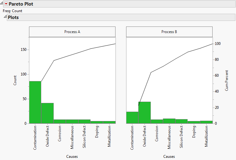

Figure 13.10 Pareto Plot Report Window
Process A indicates Contamination as the top failure while Process B indicates Oxide Defect as the leading failure.

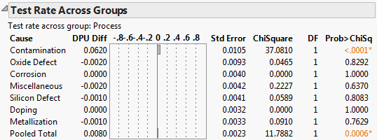

9. Click the Pareto Plot red triangle and select Count Analysis > Test Rates Across Groups.
Figure 13.11 Test Rates across Groups Results
Note that the DPU for Contamination across groups (Process A and B) is around 0.06.
