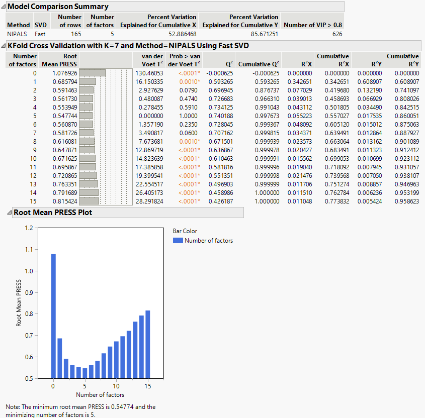

Figure 6.15 Partial Least Squares ReportĀ
The Root Mean PRESS Plot shows that Root Mean PRESS is minimized when the number of factors is 5. This is stated in the note beneath the Root Mean PRESS Plot. A report called NIPALS Fit with 5 Factors Using Fast SVD is produced.
