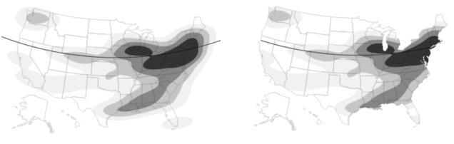

Graphical elements (display segments such as reference, grid lines, and contours) can be clipped to conform to the boundaries of a geographical map. The Customize Graph window provides Clip Shape options, where you can select a boundary around which to clip the shape.
Figure 12.38 Unclipped (Left) and Clipped (Right) Reference Lines and Contours

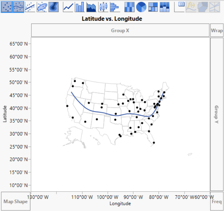

Create the Background Map
1. Select Help > Sample Data Library and open Cities.jmp.
3. Drag the Latitude column to the Y axis.
4. Drag the Longitude column to the X axis.
5. Right-click the graph and select Graph > Background Map.
6. In the Boundaries column, select US States and click OK.
A map of the United States appears on the graph.

Assign a Clip Shape
1. Right-click the graph and select Customize.
2. Select Reference Lines and select US States from the Clip Shape list.
3. Select Contour, select US States from the Clip Shape list, and click OK.
Figure 12.42 Clipped Reference Line and Contours
