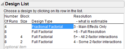

The list of screening designs that you can choose from includes designs that group the experimental runs into blocks of equal sizes where the size is a power of two. Select the type of screening design that you want to use and click Continue.
Figure 9.15 Choosing a Type of Fractional Factorial Design
The Design List contains the following columns:
Number of Runs
Total number of runs in the design.
Block Size
Number of runs in a block. The number of blocks is the Number of Runs divided by Block Size.
Design Type
Description of the type of design. See Design Type.
Resolution
Gives the resolution of the design and a brief description of the type of aliasing. See Resolution as a Measure of Confounding.
