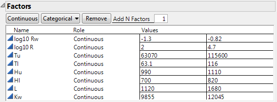

3. Click the Space Filling Design red triangle and select Load Factors.
Figure 21.29 Factors Panel with Factor Values Loaded for Borehole Example
Note: The logarithm of r and rw are used as factors.
