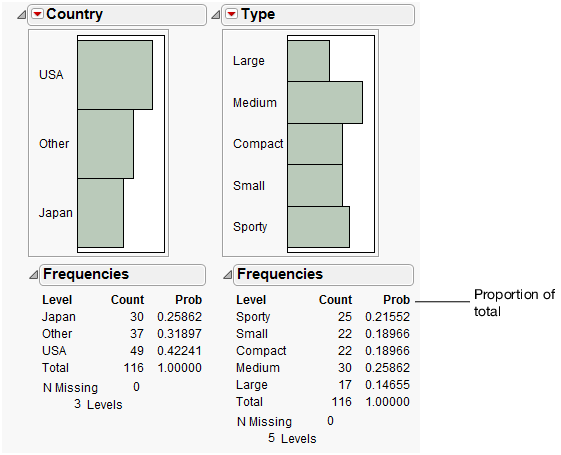

Figure 5.9 Distribution for Country and Type

The report window includes a bar chart and a Frequencies report for Country and Type. The bar chart is a graphical representation of the frequency information provided in the Frequencies report. The Frequencies report contains the following:
• Categories of data. For example, Japan is a category of Country, and Sporty is a category of Type.
• Total counts for each category.
• Proportion of the total each category represents.
For example, there are 22 compact cars, or about 19% of the 116 observations.

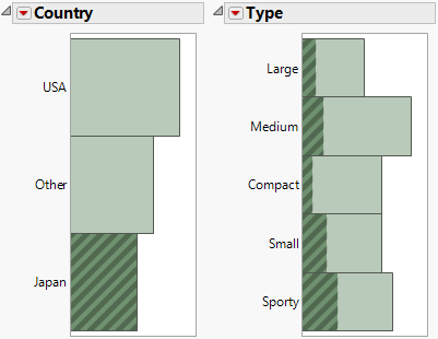

Selecting a bar in one chart also selects the corresponding data in the other chart. For example, select the Japan bar in the Country bar chart to see that a large number of Japanese cars are sporty.
Figure 5.10 Japanese Cars
Japanese Cars

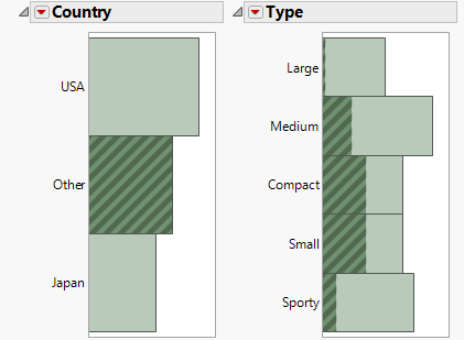

Select the Other category to see that a majority of these cars are small or compact, and almost none are large.
Figure 5.11 Other Cars
