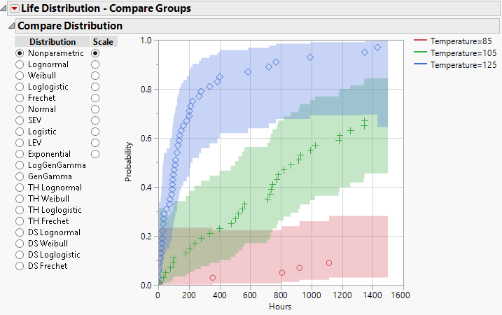

Figure 3.16 Compare Distribution for GroupsĀ
The default graph shows the nonparametric estimates. At a higher temperature, the capacitor has a higher probability of failure. You want to try fitting a parametric distribution.

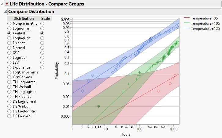

9. Select Weibull for Distribution and Scale.
Figure 3.17 Compare Weibull Distribution for GroupsĀ
When plotted against a Weibull probability scale, the points come close to following three lines. This indicates that a Weibull distribution provides a reasonable fit for each of the Temperature groups.
