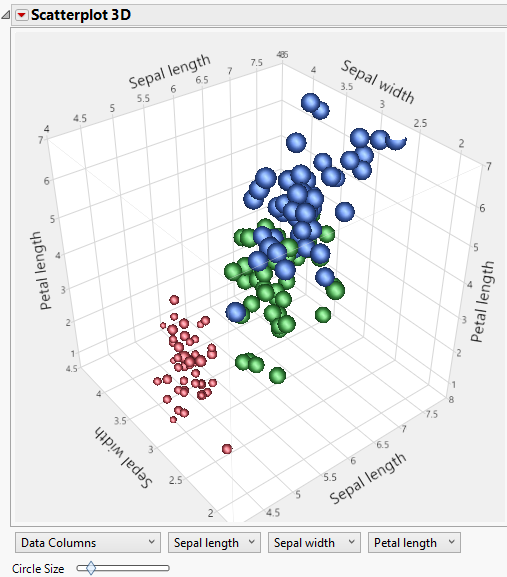

5. Click OK.
Figure 9.2 Example of an Initial 3D ScatterplotĀ
Now you can spin the 3D scatterplot to see the relationships between the variables. In this example, the data points are formatted in blue, red, and green. You might want to spin the scatterplot to see more clearly the relationships between the red and green points.
