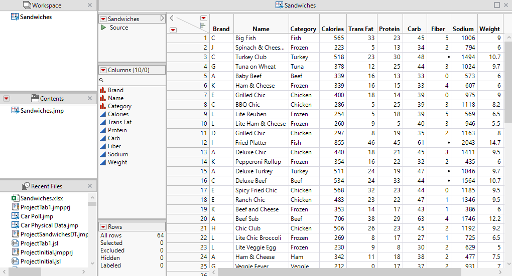

5. Select File > Save.
6. Make sure Project Contents is selected.
7. Change the file name to Sandwiches.jmp and click Save.
Figure 10.19 Project with Sandwiches Data Imported

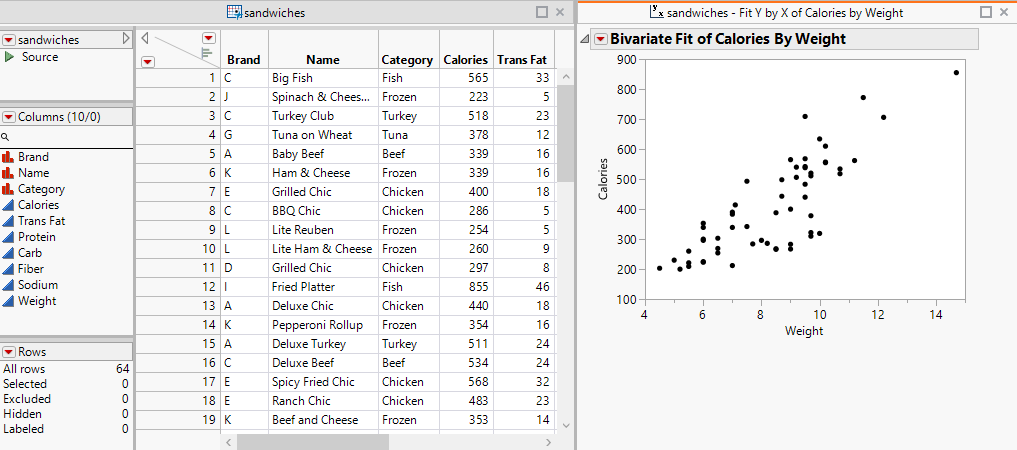

8. Select Analyze > Fit Y by X.
9. Select Calories and click Y, Response.
10. Select Weight and click X, Factor.
11. Click OK.
12. Drag the Sandwiches - Fit Y by X tab to the right and drop it into the Dock right zone.
Tip: To show the entire report, you can drag the line between the data table and the report to the left.
Figure 10.20 Fit Y by X (Bivariate) Report Docked at Right

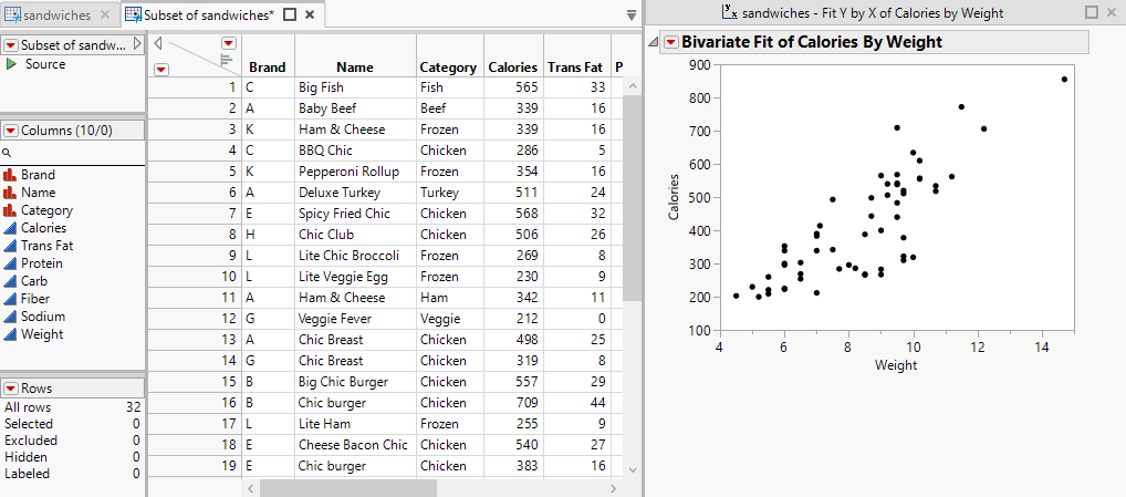

13. Select Tables > Subset.
14. Under Rows, select Random: sampling rate 0.5.
15. Click OK.
Figure 10.21 Project with Unsaved Subset Table
16. Select File > Save Project.
17. Navigate to the folder where you want to save your project, name the project file, and click Save.
18. Close the project.
19. Select File > Open and open your project file.
Notice that the subset table that you did not save has been saved automatically to the project file.
